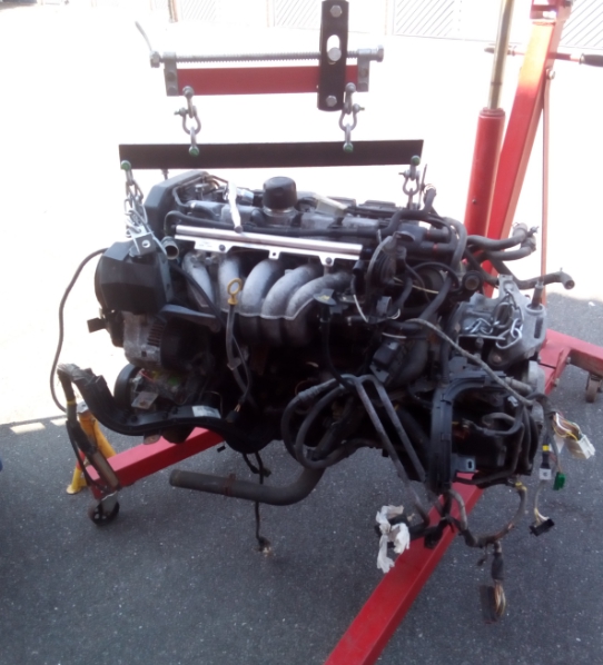

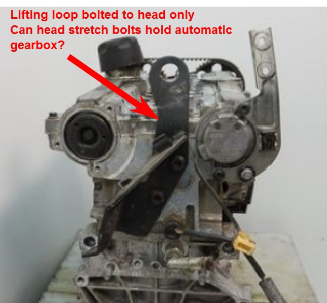

I found that the head gasket had gone bad. I have two guesses why... the automatic gearbox puts too much weight on the head bolts when lifting the engine on a crane and / or the cooling system which stopped working.

AS1 (Anne) schreef: 04 jul 2022, 21:50 You will be amazed at how much just one head bolt can take and you have 10 of them.

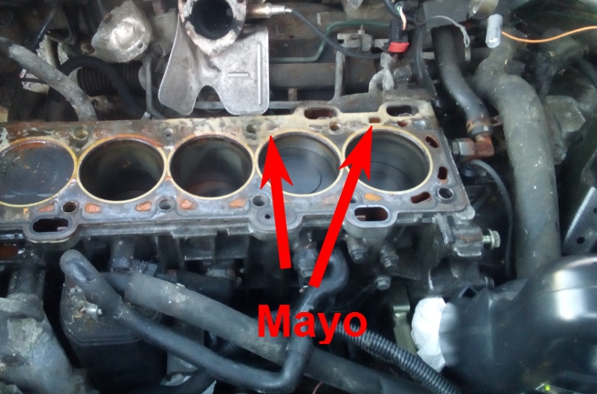

The problem is that on the timing belt side of the 2.5, the lifting loop is part of the bracket for the alternator etc which is bolted to the bottom of the engine. On the other side, the lifting loop is bolted to the engine head - which then has to support the bottom of the engine AND the automatic gearbox when you lift it. I don't think those bolts are designed for that. When i removed the head, cylinders 3,4 & 5 had white mayo round them on the head gasket. Cylinders 1 & 2 were fine however the gasket was clearly badly rusted and crumbling.
AS1 (Anne) schreef: 04 jul 2022, 21:50 How did you determine that the head gasket is bad?
I was seeing white mayo under the oil filler cap.

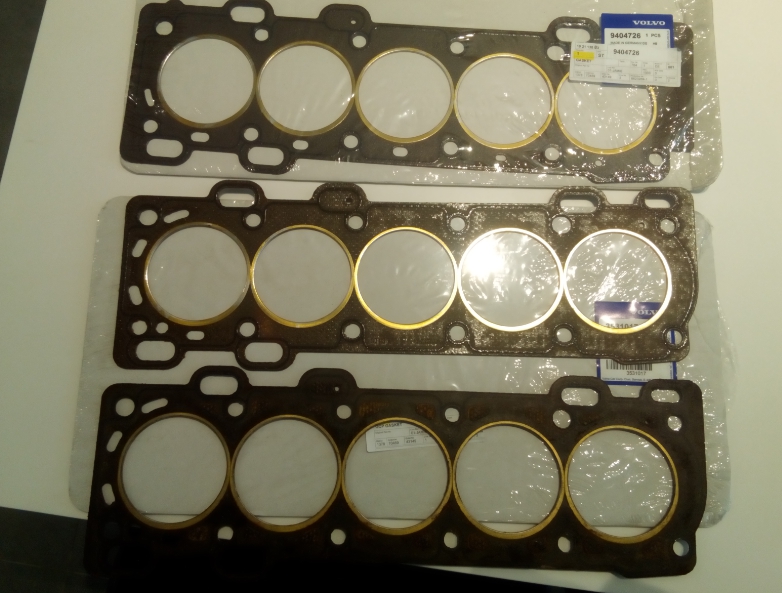

I had to buy a new head gasket from Volvo dealers for this engine. That was tricky as they had no idea which one to order and they're all different even though there are many engines using the same basic engine block / cylinders. Eventually we narrowed it down to two - the B5254S or the B5254FS. He ordered in both for me so we could compare them. Can you spot the difference?!!
The one at the top is for the B5254S.
The middle one is for the B5254FS.
The bottom one is the one i removed from the engine.
On the left side of the one at the top, there is two holes missing - look at the one below and you will see there is an extra hole like the original at the bottom!!
